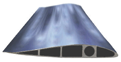

Pala extrudata :
  • Imagine atasata: post-14-1130429220.gif
Go fly, young man ! GO FLY !!!
