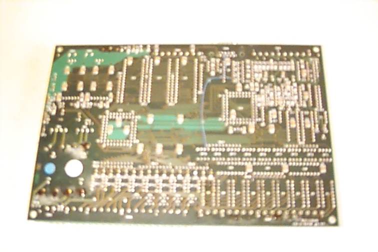

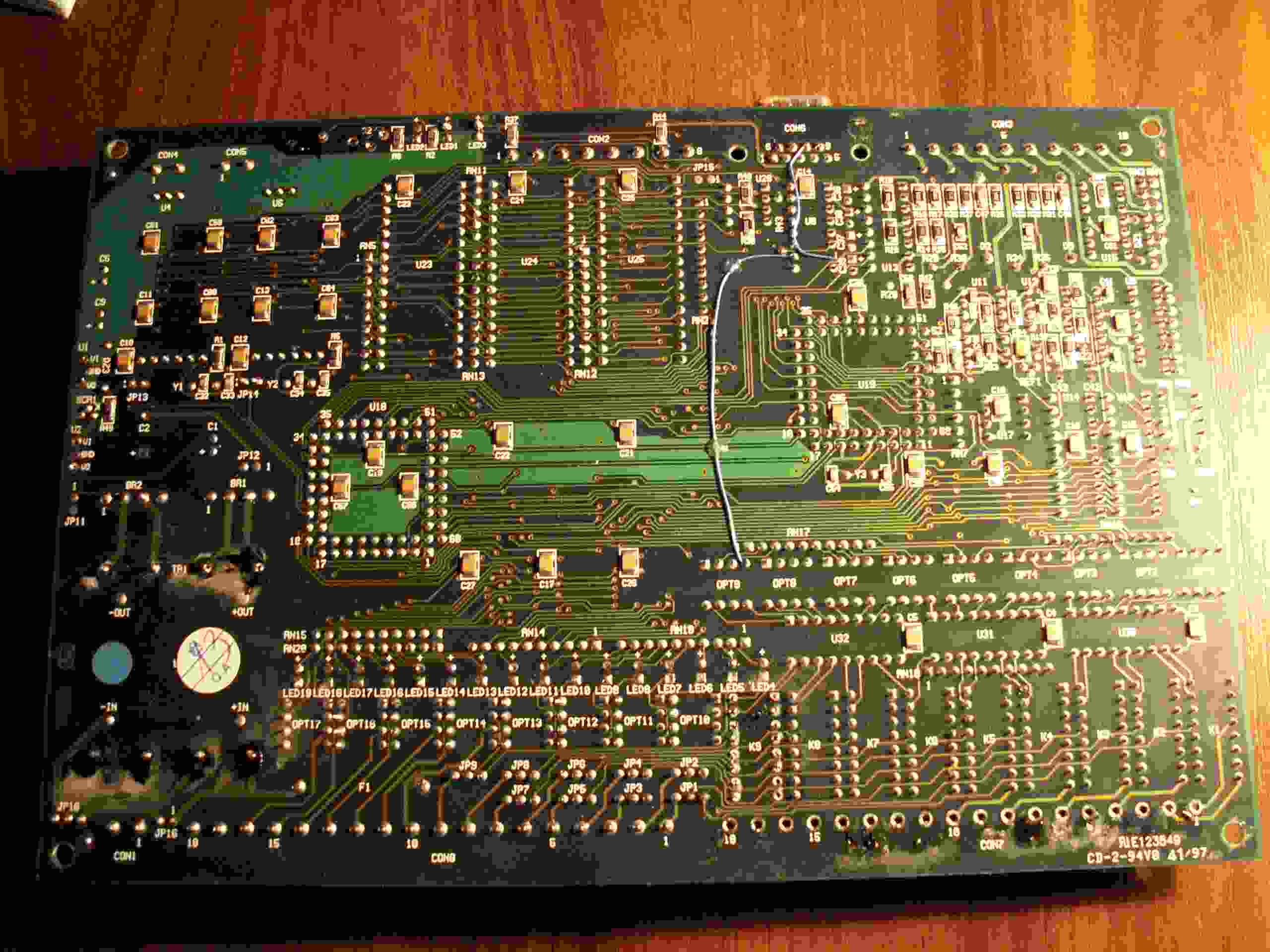

#29
Postat 13 October 2005 - 02:18 PM
Este facut in OrCad 9.21, pe 4 fetze: doua interioare si 2 exterioare !! gauri metalizate, masca de lipire, stanate, inscriptionate, plantate SMD, verificate, testate, etc.
