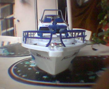

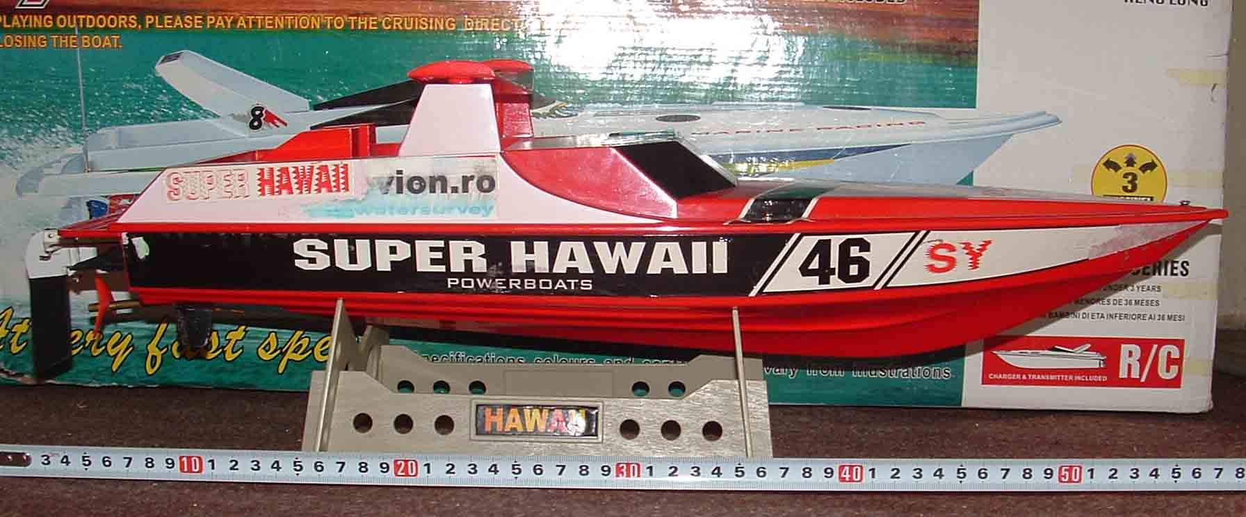

Am venit cu poze....
  • Imagine atasata: post-4-1117638964.jpg

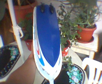

Postat 01 June 2005 - 05:16 PM
Poza din fata...
  • Imagine atasata: post-4-1117639011.jpg

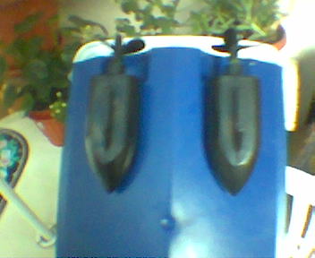

Postat 01 June 2005 - 05:19 PM
Barca pe burta.,.
  • Imagine atasata: post-4-1117639143.jpg

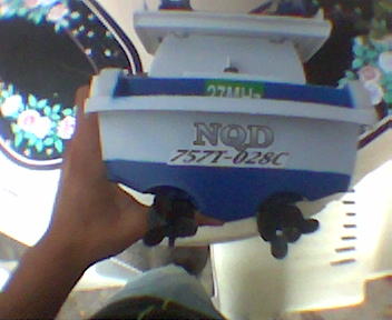

Postat 01 June 2005 - 05:20 PM
Barca tot pe burta..dar poza mai amanuntita la motoare si carma...
  • Imagine atasata: post-4-1117639200.jpg

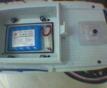

Postat 01 June 2005 - 05:21 PM
Poza motoare
  • Imagine atasata: post-4-1117639275.jpg

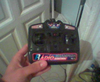

#30 Useril este offline   Blak
  • Postari: 26
  • Inregistrat: 30-May 05

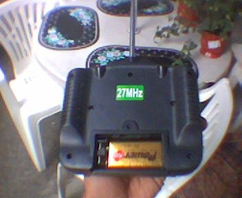

Postat 01 June 2005 - 05:23 PM
Poza telecomanda 1...
  • Imagine atasata: post-4-1117639410.jpg
