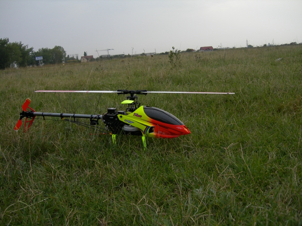

Postat 06 February 2008 - 01:30 PM
Titan STock
  • Imagine atasata: post-27-1202297446.jpg
West Hobby Team

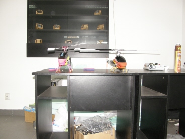

Postat 06 February 2008 - 01:34 PM
mt kasama
  • Imagine atasata: post-27-1202297698.jpg
West Hobby Team

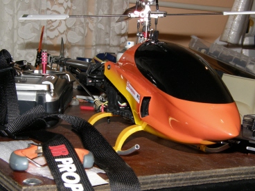

Postat 06 February 2008 - 01:39 PM
TT tuning
  • Imagine atasata: post-27-1202297957.jpg
West Hobby Team

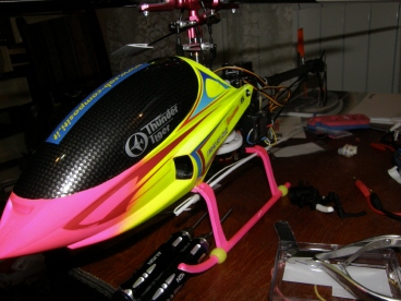

Postat 06 February 2008 - 01:40 PM
Neu motor
  • Imagine atasata: post-27-1202298025.jpg
West Hobby Team

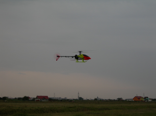

Postat 06 February 2008 - 01:41 PM
low profile mt vs normal
  • Imagine atasata: post-27-1202298087.jpg
West Hobby Team
