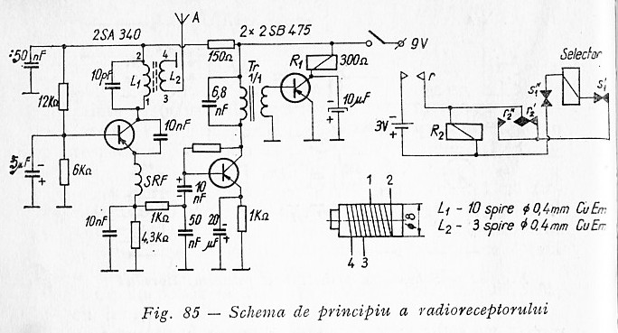

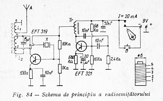

Poate te ajuta asta .
  • Imagine atasata: post-8-1203066140.jpg
Vand ESC cu revers home-made : http://www.rhcforum....si-switch-navo/
#22 Useril este offline   Everest
  • Postari: 126
  • Inregistrat: 30-January 07
  • Location:SIBIU
Postat 15 February 2008 - 11:03 AM
  • Imagine atasata: post-8-1203066213.jpg
#23 Useril este offline   Everest
  • Postari: 126
  • Location:SIBIU
Postat 15 February 2008 - 11:05 AM
  • Imagine atasata: post-8-1203066310.jpg
#24 Useril este offline   Everest
  • Postari: 126
  • Location:SIBIU
Postat 15 February 2008 - 11:06 AM
Schema TX .... pentru distanta mai mare ii mai faci un etaj de putere sau ii schimbi EFT319 cu unul mai puternic.
  • Imagine atasata: post-8-1203066380.jpg
Aceasta postare a fost editata de Everest: 15 February 2008 - 11:11 AM
#25 Useril este offline   Everest
  • Postari: 126
  • Location:SIBIU
Postat 15 February 2008 - 11:08 AM
Schema RX
  • Imagine atasata: post-8-1203066500.jpg
